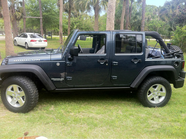

Your logic is flawed. My jeep did not have a bad rake. Rubi springs are stiffer than stock sport spring. That's why they come with 32s and can fit 35s with flat fenders. You can't say that about sports.
Stock pic
A rubi unlimited springs sit over a 1" taller than a sport unlimited with out including tires and will give over 2" on a 2 door.
