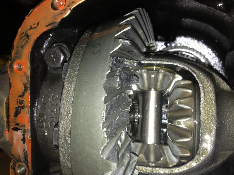

x 100000000 I agree thru experience!!!!!!
I blew my gears 5.13 with my built up Dana 30 and you're throwing more money then I did into your 30..... If I could only turn back the clock I wouldn't waste a dollar on the Dana 30 and would have GONE STRAIGHT TO THE PR44!!!!!! Too late for me now... BUT ITS NOT TOO LATE FOR YOU lol!!!! My PR44 is being ordered this week. I decided on it last Thursday and I'm not looking back.... PR44, ARB air lockers, RCV's, Dynatrac ball joints, Reid knuckles, 5.13 gears etc...... SERIOUSLY DO YOURSELF A FAVOR GO STRAIGHT TO THE PR44...... The tiny R&P on the Dana 30 is going to let you down..... Good luck
