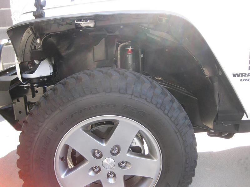

I took my dremmel & carefully cut little by little what I didn't need making sure to not cut off the holes where the push-pins go so I can stick it back in there using the original holes. It takes some extra time and going back and forth, but it was worth it to me because it helps with all the crap that gets flung around when wheeling and driving on the roads. Some scheers work well too. Just remember, measure twice cut once! lol

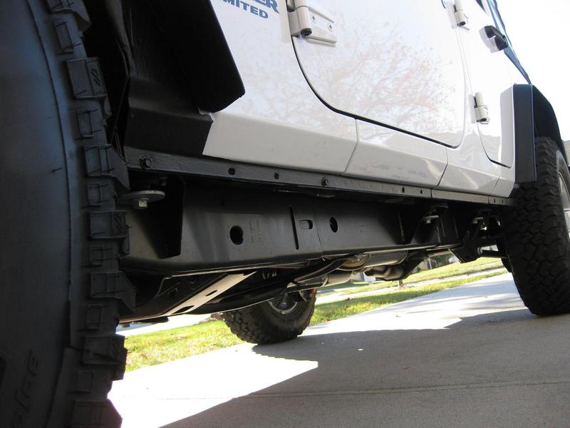

Here's what I did (pics below), just cut the rears about a 1/2 inch out to maintain the factory mount points and I think they look fine. I wanted to keep the liners since I'm in snow/salt country. I did paint and bedline as if I was going to run without them though.
