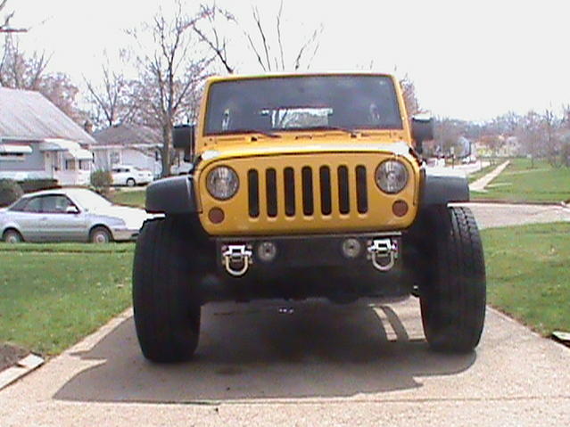

Old Jan 16, 2011 | 02:15 PM
Posts: 43
From: Cuyahoga Falls, Ohio
ID:	118293I took the ugly plastic off, cut the crush cans off, cut off the ends to make a stubby, put my stock fog lights in using toliet bowl flanges I found at Lowes and trimmed them to fit. bought some d-rings, done. For some reason it is not allowing me to attatch a pic. go to my page and look at my pics.
