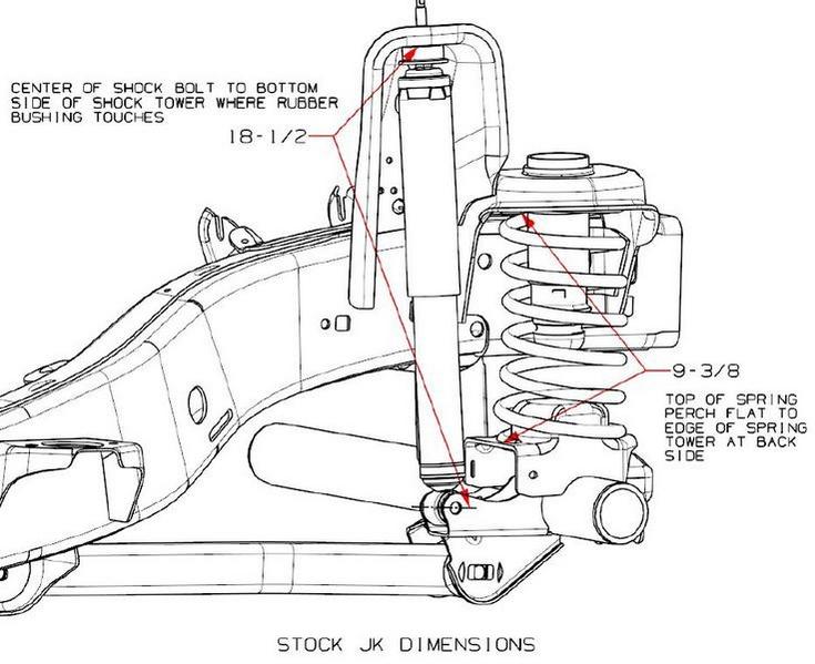

This souls help on front

Thanks but trying to get measurements from ground to pinch lower seam corners or rubi rails
