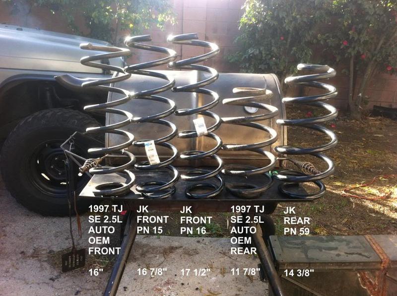

The pic below shows the difference between a 15 and 16 so there is no way a 14 and 18 could be the same height.

I will add that my 60's measured a bit over 14.5"
