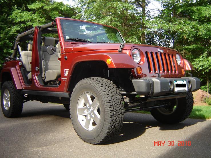

It's been done for a while but just got around to finding the camera, Looks pretty much like everyone else's i guess. I used loctite to "glue" the brass insert back in, which worked well. Went with Black #8 sheet metal screws from the local hardware store. Cheap, easy and plentiful. Thanks to everyone for the ideas and great wrie-ups. This board is awesome.

Looks good what did you use to re-attach the end caps.... rivets?

Black, #8 phillips head sheet metal screws from True Value hardware. Mainly because it was easy and I don't have a rivit gun.

I used sheetmetal screws, too, but temporarily, until I got some exploding rivets. I was tempted to just keep using the screws but in the end being afraid of screws backing out and causing a flat made me go w/ rivets. Something to think about.
