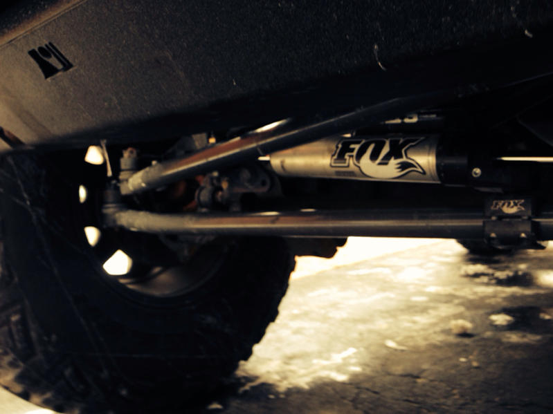

Old Jan 25, 2014 | 11:17 AM
Monte417's Avatar
Posts: 1,444
From: East Meadow, NY
Go with the synergy stuff it's made out of chromoly and they give you one ton tie rod ends

Originally Posted by kbp810
It will hold up just fine unless you plan on bumping into something with it.
Mine held up fine on 37's, up until a big log put a bend in it.
If you don't plan on possibly bumping into something with it, you should be just fine... but if so, I'd consider carrying a spare stock takeoff, or upgrading.
I went with the Rock Krawler Aluminum one myself, as you can see I haven't stopped bumping into things
(not that it was intentional - a tie rod that can take a hit is still no substitute for proper lines or a good spotter)
Hard to tell but are you missing the jam nut on your drag link?
