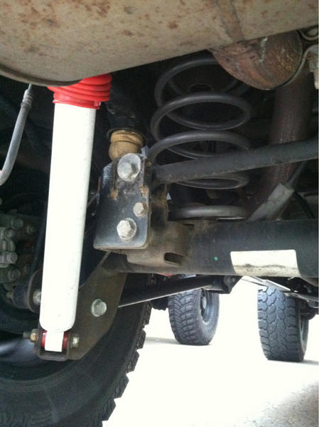

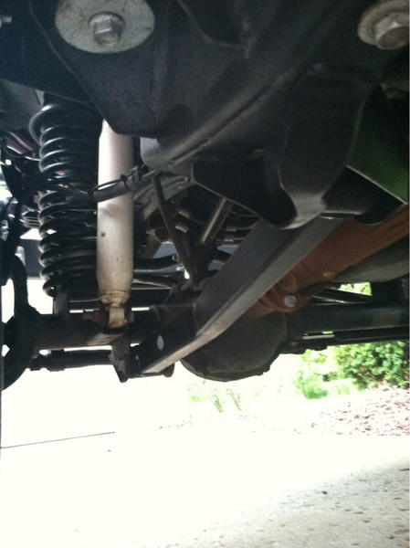

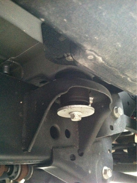

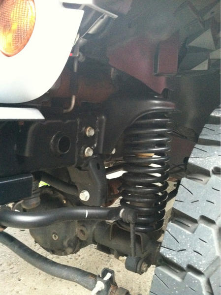

Here are some pictures of the suspension guys....

Ok guys, after punching in some serial numbers off the shocks it appears this is a Skyjacker lift. Probably a 2.5" lift.
The previous owner took all stickers off all the aftermarket components so it's a bit of a research project

You have aftermarket springs, I don't feel that's your problem. I think it's the hydro shocks. Look into some gas mono tube types.
Also you might never have a problem but I would look into replacing your rear track bar relocation bracket. They are notorious for snapping factory welds at track bar axel bracket.
