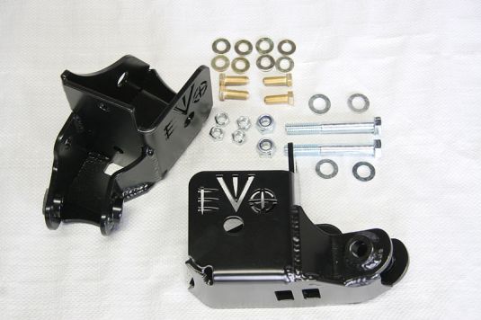

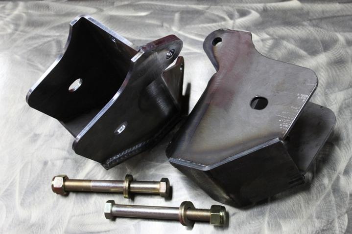

I have checked out the EVO rockstar skids but what happen when you move the shock up 1.5" wont you loose wheel travel? I like the idea of more ground clearance. I also been looking at the Rebel offroad Ginders which keeps the shock mounted at the stock location. What do you guys think? Also just checked out the Ruff Stuff and the Riddler diff covers both are very impressive. Where do the ARBs stand? I really like the looks of them but are they as good as they say they are? Thanks again

Your travel will more than likely be limited by tire rub and bump stop more than it will be by your shocks. You will however gain an extra 1.5" of droop.
This is true. The shocks have alot more travel. The bumpstop will stop your travel way before the shock reaches it's full travel. I have the skids and they work very well. plenty of rash on them which is good.
