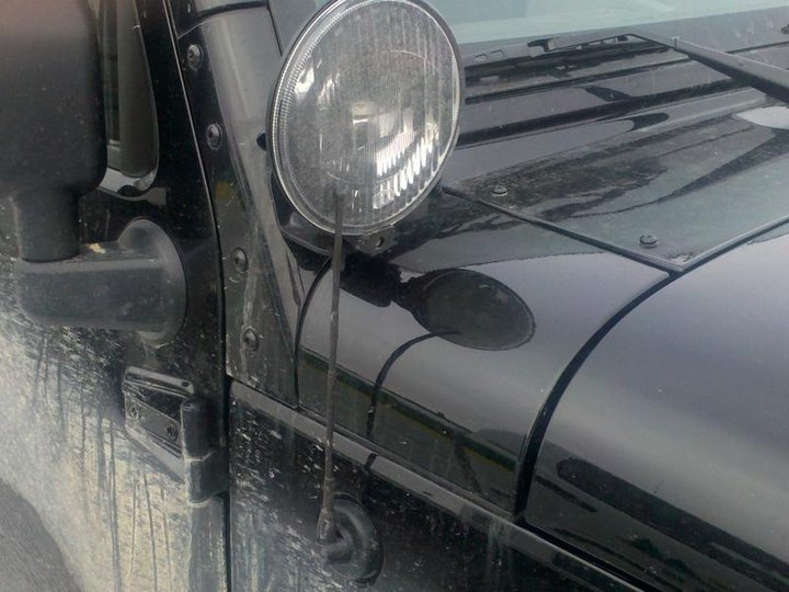

I'm running the same brackets with Hella 500's mounted on them. I just cut my stock antenna down to 8" total length (not including the threading) and it clears the bottom of the light by an inch or so.
I used a bench grinder to cut it and shape a point on the end so I could reattach the little ball to the end of it and then put some black heat shrink tubing on it. Total cost...prob about $0.73 and 15 minutes of my day.
The above pic the antenna is 10" long. I did the initial chop before I installed the windshield lights and then shortened it up again after I got the lights installed but you get the idea. Also I should add that I haven't once noticed any major loss in radio reception over the stock length if that is a concern

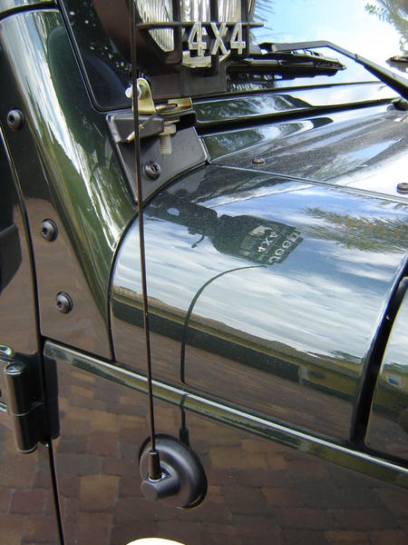

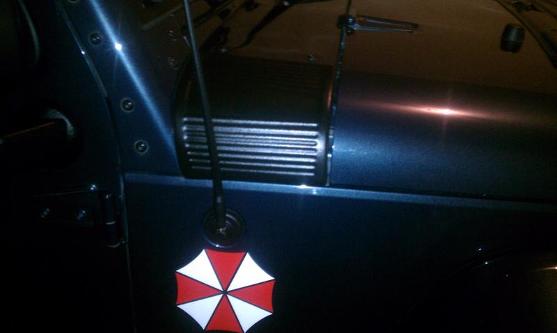

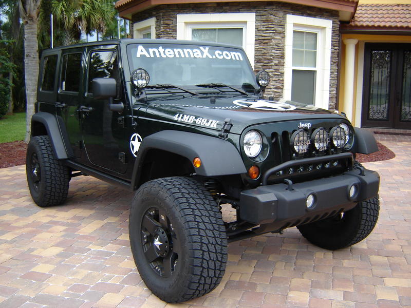

Thanks for all the positive feedback on our antennas!! We are now a Supporting Vendor on JK-Forum.com so if you have any questions about short replacement antennas just let us know. We are also a fellow Jeep enthusiast and own a 2010 unlimited.
