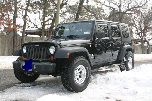

Plan the cuts in the plastic use a soldering gun with a flat tip to plastic weld used scrap plastic to build weld and a propane torch to heat. Do all welding from the inside finish outer seems with soldering gun.
