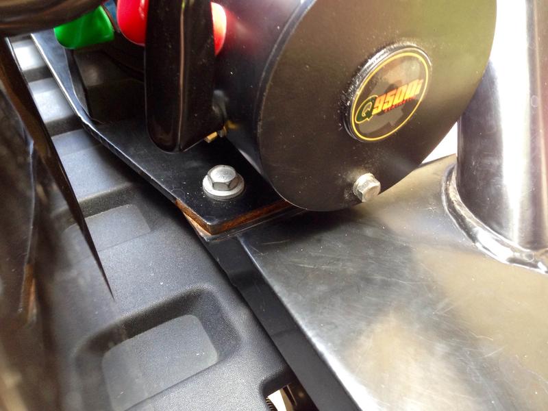

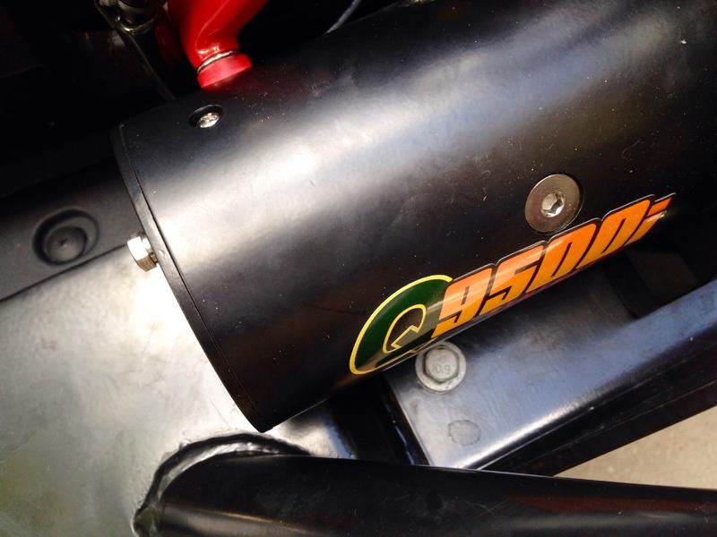

Running into some trouble with my Quadratec 9500is winch install. Two quick questions for those more knowledgable that I (99% of you):
1. How the heck am I supposed to tighten this Rampage winch plate onto the Rampage Front Recovery Bumper? These bolts are nearly impossible to get to, much less get any torque on!
2. My 4 year old helper seems to have misplaced the bolt that attaches the winch line to the winch drum (had to be removed to feed the line through the fairlead). Quadratec has offered to sell me a replacement for $6.98, but would not just tell me what size bolt it is so I can just run to Ace Hardware and get one for $0.25. Anyone know what size that bolt or screw would be? It's sole purpose is to hold the line to the drum - it doesn't support any weight or pressure.
Pictures of problem #1 attached:

I do not know about the drum screw. As far the bolts to attach the winch plate to the bumper, it looks like the plastic filler between the grille and the bumper is still in place. I would remove that and consider just leaving it off.

When I put my bumper and winch on(not rampage but after market none the less) I attached the winch to the bumper first to save some headache..
Yeah, I think you're right. Going to have to take the bumper off to get to that one (rear passenger). I still won't be able to get a torque wrench and socket on it, so I think I'll just pull as hard as I can on a wrench and cross my fingers.

Regarding the mounting, it's absolutely easier to install the winch to the bumper, then install the bumper to the Jeep. I recommend a second set of strong arms to help with the install as it will be heavy!
