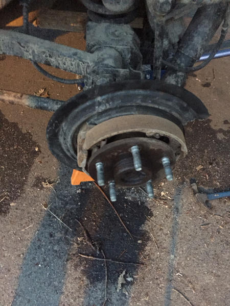

I've been recently hearing a loud metal like bang/clunk whenever I hit a decent bump or cycle the suspension coming from the left rear. I tried pulling the left rear shaft and it's insanely stuck. I've tried everything from pry bars and axle pullers and it still won't budge. I've wheeled it for about a year and have always used technique over throttle. I know bent housing can cause this but I figured maybe someone knows something else to try. 2010 rubicon..stock shafts..37s

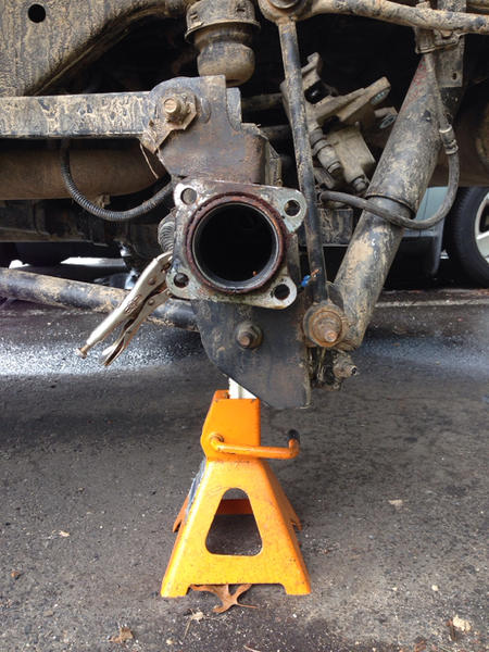

Just got the shaft out..twisted splines and the flange was twisted as well so I guess it's time to upgrade

Pic of the axle tube..notice the twist

If you twisted the axle tube, you need more than an axle shaft...

As i recall, that flange isn't always straight (depends on where your pinion angle is set). Compare to the other side. Also, check the plug welds. If it really did rotate, those would be sheared off (it has happened). If the tube isn't bent, just weld the tube to the cast and that will prevent any future issues.
Or, upgrade, haha. Just making sure you don't spend money you don't want or need to spend.
