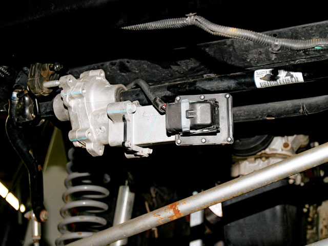

If it works, the unit is probably fried. Crawl under the front end of your jk. Lying on your back look straight up at the front bumper. Unplug the wire. See photo.

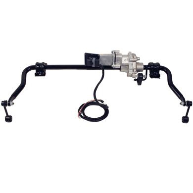

Here's a better pic.

If the unit is fried, check out the Evo no limits manual swaybar disconnect. It will replace the bad motor. A new sway bar is stupid expensive.
