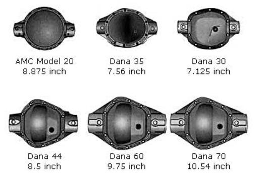

Where would i be able to find out if i do have a dana 35? And wat gear ratio i have i bought it used so i have no clue....07 wrangler i mean does in like say on the dif? Or somewhere in the truck?
Here's a chart

Go to the main Jeep website and find the Contact Us section. You can email your VIN and request a build sheet, which will show the axle and gear ratio that it left the factory with.

X2 on the build sheet. It will tell you everything
