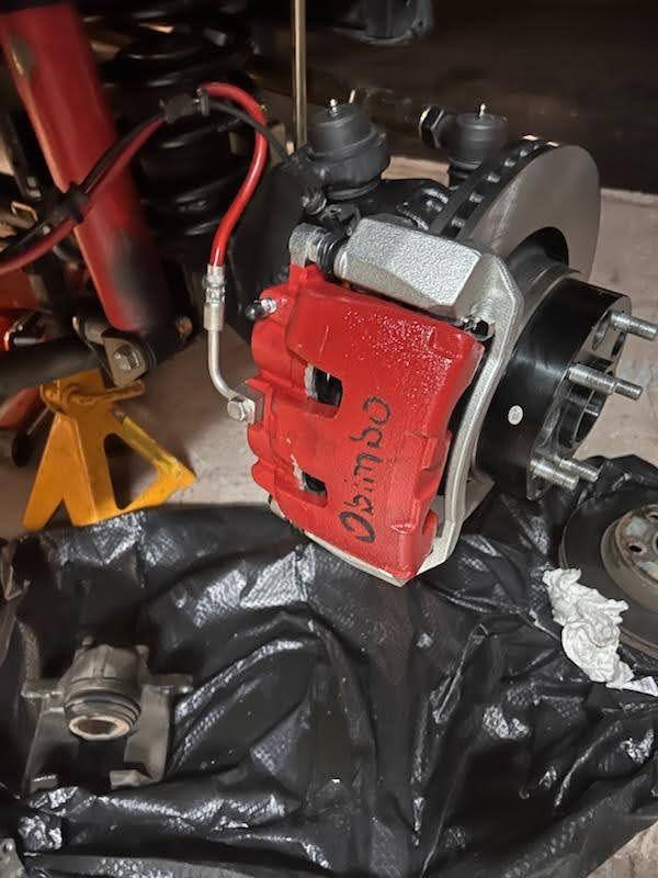

Got my new Bimbo brakes installed, and they work a treat! With the 37's the difference from stock is absolutely colossal; very happy with them.
Bimbo Brake Calipers

Bimbo? Link?
