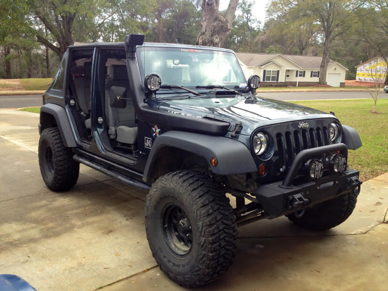

33's would look a bit small, I'm running a 3" Teraflex lift with 35's. I have 2 small kids, no trouble getting them in/out. I would say go 35, they will just fill out the wheel wells that much better.
