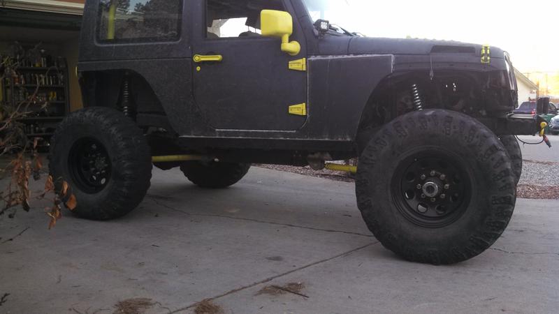

Old Feb 12, 2015 | 05:45 PM
Maertz's Avatar
Posts: 4,482
From: Neenah, Wisconsin
Got them on mine. Will be doing weld on beadlocks when i get new tires. Mine are 3.5 backspacing i believe. I need a 5th yet may have to grab one on sale and save 10 bucks lol

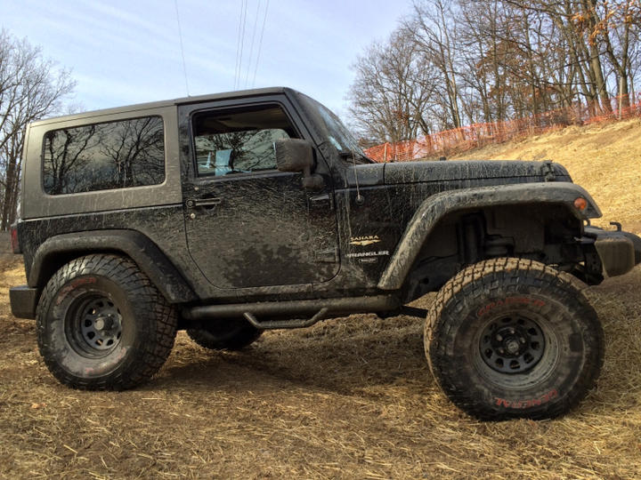

scafootballpro5's Avatar
Joined: Jan 2015
Posts: 262
From: United States
Got similar D-windows on mine from JEGS brand. 15x8 with 3.75" backspacing. The backspacing is from the inside of the rim (therefore lower the number the further it sticks out) and offset is from the outside I believe.
