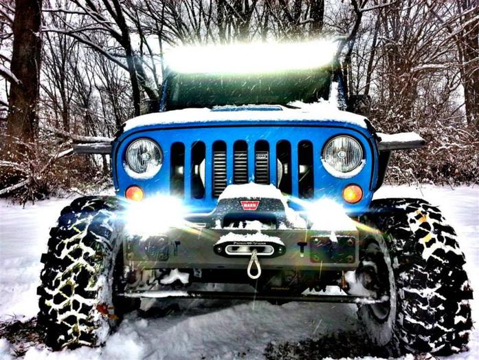

ive had a ripp supercharger on a couple jks.. happy with the power.. easy to install. inner cooler looks cool lol no issues with mine. gives the jk the kick it needs
