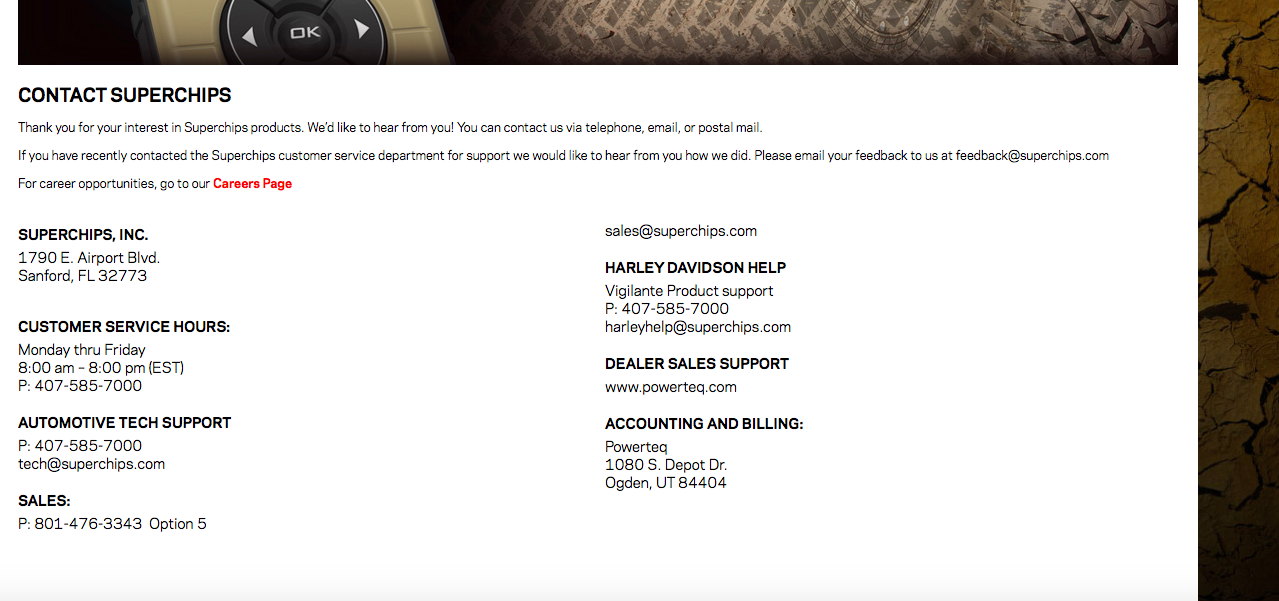

Their customer service has been closed since the time i have been able to "use" it. Will find out this week during normal business hours if my schedules allows me call. No formal email response/ auto response from spark software regarding my custom tune.
There is a Superchips forum as well. May get answers there.
Thanks, Didn't find what i need. Still waiting... I have not been able to call during 8-5. I have tried emailing support and waiting for a response. Interesting that their website says support is 8am-to8pm. That is unless you call and then you get a: please call back during regular business hours of m-f 8am to 5pm
