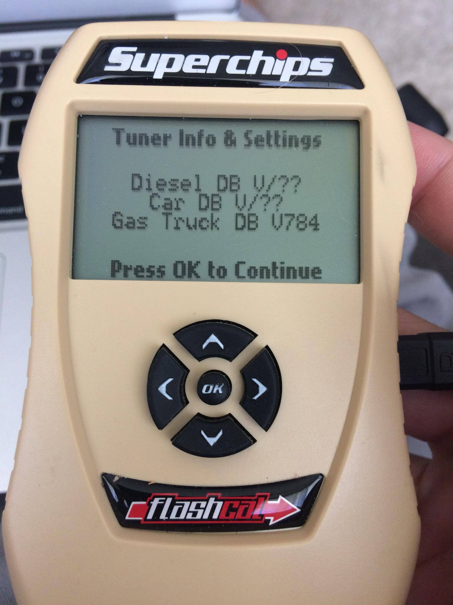

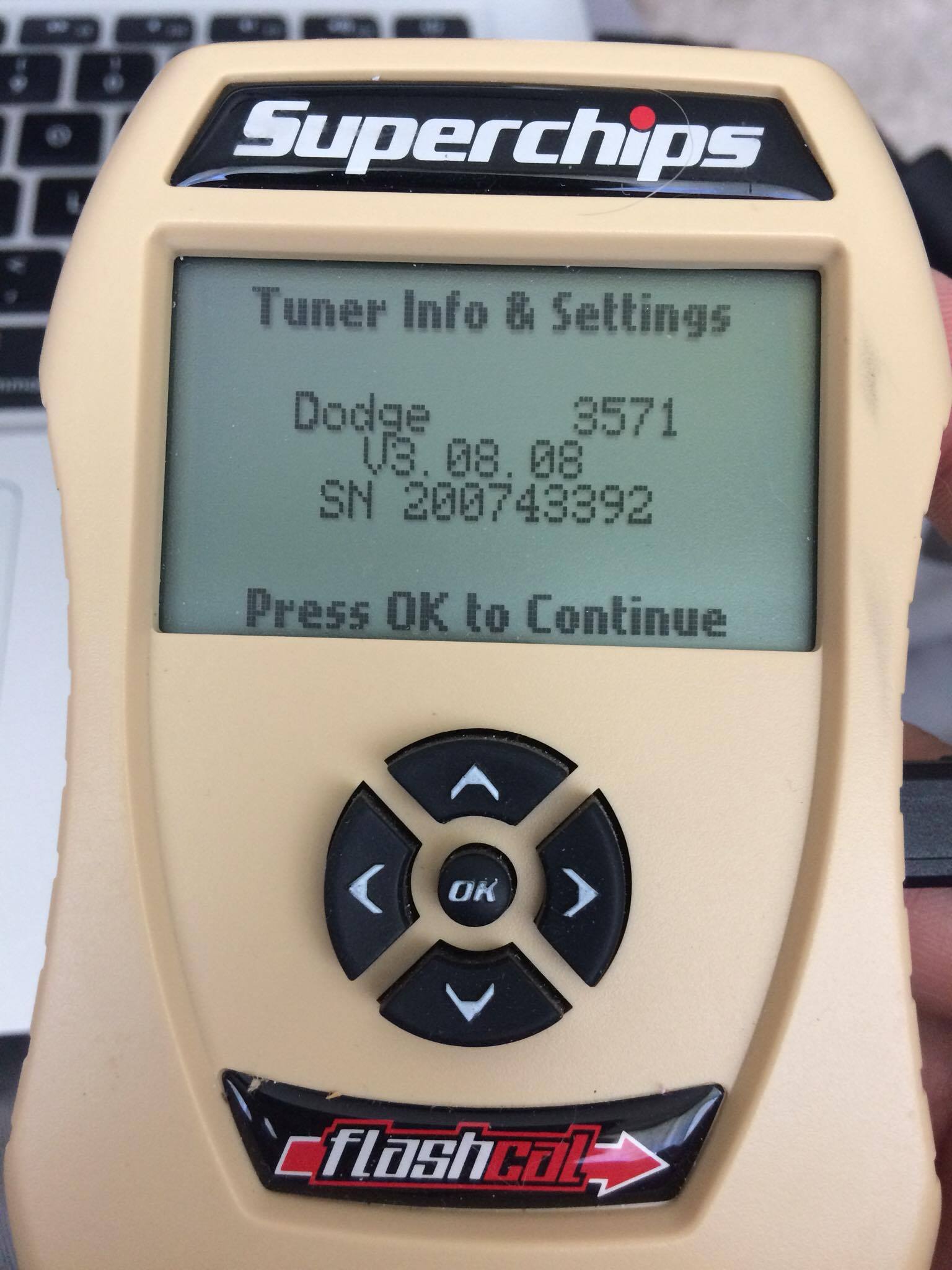

Hey all, I recently upgraded my Flashcal to Flashpaq, but I'm concerned and have a few questions for those of you who have done the same. I went to do the upgrade and it failed several times at first. Once I was able to complete the upgrade I got the following screens.
After I saw these screens mentioning "Dodge" and various engines that the JK doesn't have I called Superchips to verify and I got a very short/rude response from one of the tech guys "Dodge is the same as Jeep, is that all?" So after feeling like a complete idiot, I asked him if there was anything else we could verify to ensure I had the proper software, and he said "no" without even asking the S/N or version numbers or anything. Granted maybe he is correct and I do have the right stuff, but a few extra mins to verify would have made me feel better.

Something just doesn't seem right, so I'm asking the JK world if anyone else has encountered this, and or if your screens say the same as mine or if you have different things showing up when you plug yours in.
I find it extremely weird that it's has a screen that says 5.7 and 6.2 and mentions a Diesel, Car etc.

Get them on the phone and have them send you the correct file for your Jeep. Once you give them the device serial # they can attach the correct files needed so when you plug it into their program it will find your device and start downloading the correct files they sent you.
You will need to go back to stock first
I recently had to reset my tune due to having to remove the tune for a dealer flash. I was in contact via email with SC and they had me verify the tuner had the "gas truck db788" before doing the tune. It failed and they had me flash the flashpaq again and verify this time I had "gas truck db789", which as a former IT guy, I assume is Database Version 789. I did and the tune completed successfully.
