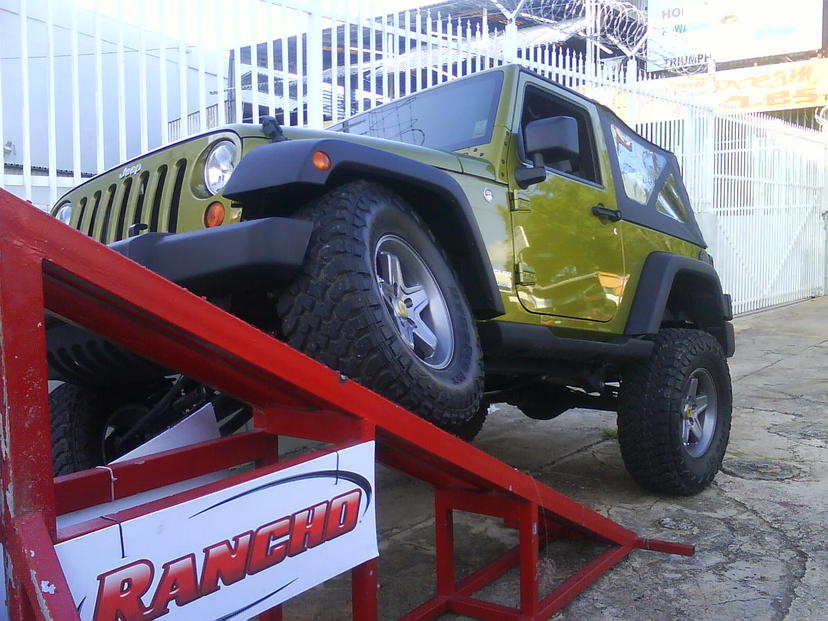

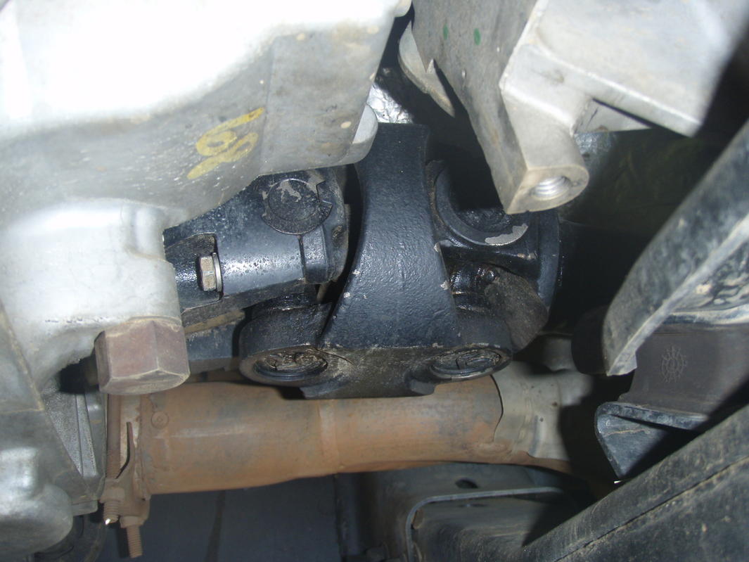

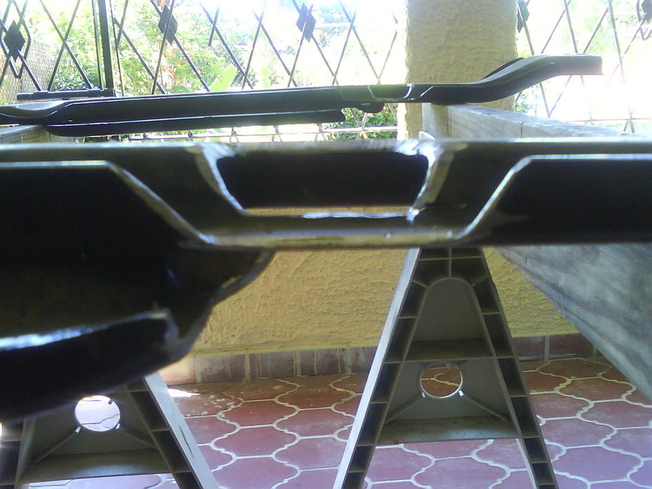

I have a JK 2Dr with BD is a 4 1/8 lift. You need a Front driveshaft,skidplate clearance cut for front driveshaft,Brakelines not the brake relocation mount and for max flex sway quick disco.Later you can ad the control arms and rear drive ShaftClick image for larger version

I beleive that people get away with it on the 2 doors for a while, but it is kind of a ticking timebomb. You will need arms for sure if you replace the driveline, you will never get the vibes out if you don't.
Give it a shot, may work for you long enough to build up more funds.

With a manual is not so critical
