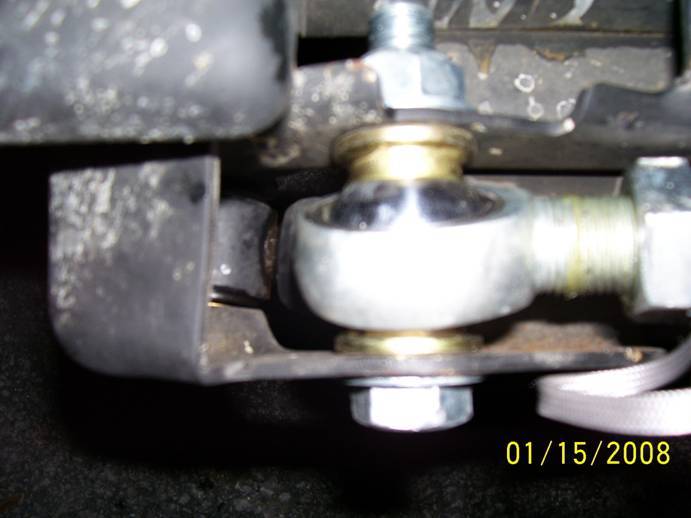

I hope this helps.....Click image for larger version

Hmm....
That's exactly what mine look like. I'll try putting it in the vice again and crank down a little harder to make sure they're seated all the way. If not, I guess I'll have to take a measurement and have a little milled off.
Thanks for going to the trouble for the pic. I'm sure that wasn't an easy spot to get into.
