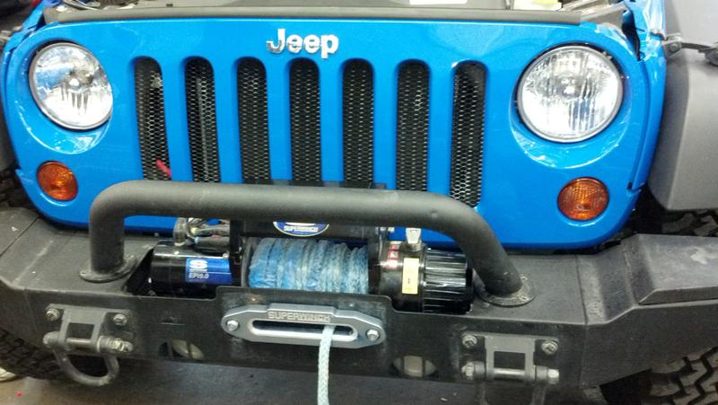

I have the Superwinch EPi 9.0 with the synthetic rope. It has a 9k pull and does just fine. YOu have to remember when you a using the winch its not an empty vehicle you are pulling, the rule of thumb is to go with double your vehicle gross weight. It never hurts to have more pull, you never know when you will need to pull a larger vehicle out.
