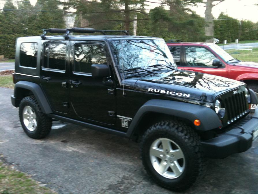

I use the thule gutter rack , works great for surfboards , just place the gutter racks behind the freedom top , too hard to explain here is a picture. The racks are only a foot and a half apart or so. It will hold a ten foot longboard with no problems. If you need a closer picture just let me know.

I use the gutter rack as well. Works grea., I put both my mountain bike and surfboard up top, no problem!
