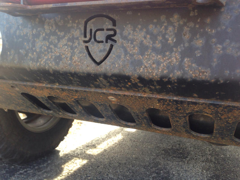

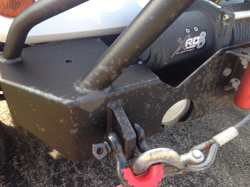

I have a JRC front bumper/skid plate that I had powder coated a little over a year ago. I'm not religious about washing my Jeep, but when I did yesterday (finally nice out)- I noticed a pretty significant amount of surface rust on it.. including my powder coated winch fairlead.
Did I get a crap powder coat job, or is this normal? I am in northern IL, so I do have salt on the roads in the winter.. but it also wasn't my DD this winter.

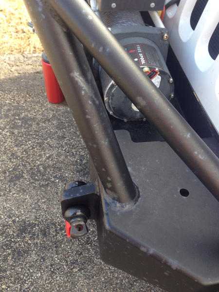

Here's some pics. As a side note- the 2.5 year old powder coated from factory, smittybilt side steps hardly have any of this.. if any. Keep in mind that my bumper is only about a year old.. maybe 1.5 years tops and was hardly driven this winter.

That is from crappy work when powder coating, metal wasn't cleaned and prepped and then a thin layer of powder

Oh yeah...that's crap powder coating.
I'd really take it off and get in lineX'd for peace of mind.
Anything you rattle can on is gonna crap out again anyway.
