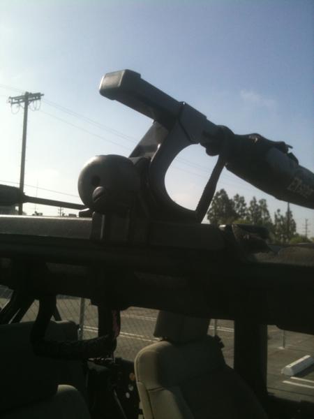

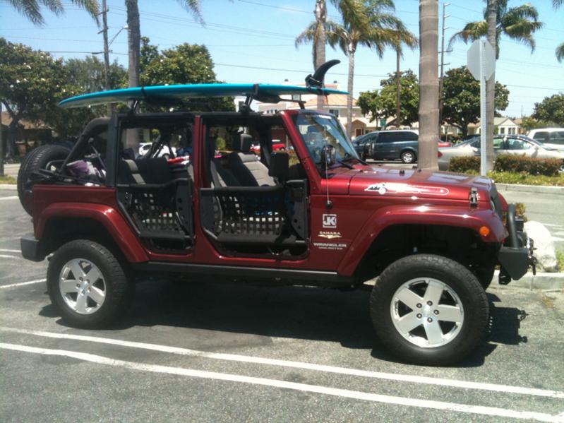

I use a Thule rain gutter mount on the soft-top door surrounds... works fine, even at 65mph on freeway. Under $200 for everything you'll need (mounts + load bars).
Thule & Yakima make a rollbar mount which a lot of Jeeps use, but they don't fit on the JK with the padding.

Couple more closeup pics of how I have them mounted:

I don't see why it shouldn't. This setup isn't the "most" stable of solutions, but a surfboard doesn't weigh much. I originally got this for my hardtop because it fits the rain gutters to carry skis & snowboards, and it mounts to the door surrounds in a similar fashion. I don't know the average weight of a kayak. I know they make kayak mounts that mount to the load bars.

I would be afraid to put so much weight on that plastic with a kayak. I'm thinking I might just build something that will mount like the freedom top kinda.
