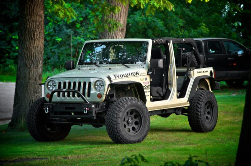

Hey guys, I want to upgrade my suspension, I say it like it's some easy decision, but it makes my brain hurt trying to figure out what I want. I'm on a budget to start off with, I have a TeraFlex leveling kit with 295/70R17 Trail Grapplers I want to maintain the height it's at right now, I don't like the look of a high top heavy JK, I'd rather have a low aggressive look. It's my DD but explore every once in awhile, and plane on hitting the badlands a couple times this summer. So what I'm looking at right now is:
Keeping the leveling kit and stock coils
Front and rear Bilstein 5100 shocks
Bilstein steering stabilizer
JKS adjustable track bar
And later down the road I'll probably go with some 2 in. TeraFlex coils I just don't have the extra $500 for them at the moment.
Would this setup work? With no problems?
Here's a picture of my JK now, so you can see the stance and height is like to keep it at ...

I'd say yes to the Bilstein shocks (0-2" lift) for an improved ride. Why the Bilstein SS and JKS ATB? Your leveling kit shouldn't need it. I'd save the cash until you purchase a complete lift kit, your Jeep looks great btw.

Could I run the 5100's (2-3.5in. Lift)? That way when I purchase a 2-2.5 in lift down the road I won't have issues? The leveling kit raised it 2in. In the front and 1 in. In the rear.
Thanks haha it's an on going project, I did alot of engine stuff no I want to upgrade the ride and flex.
