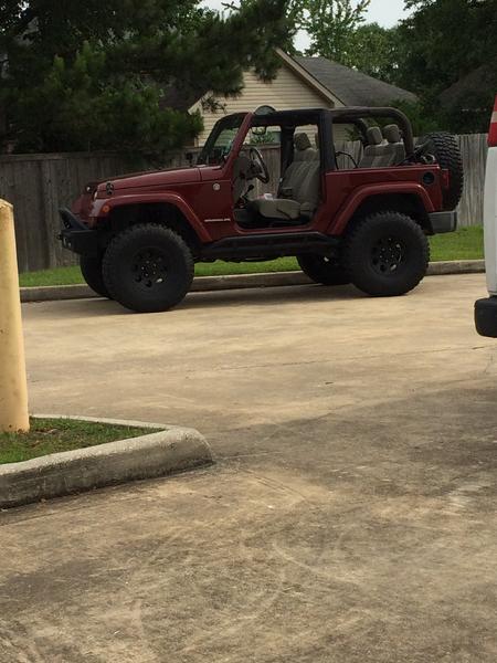

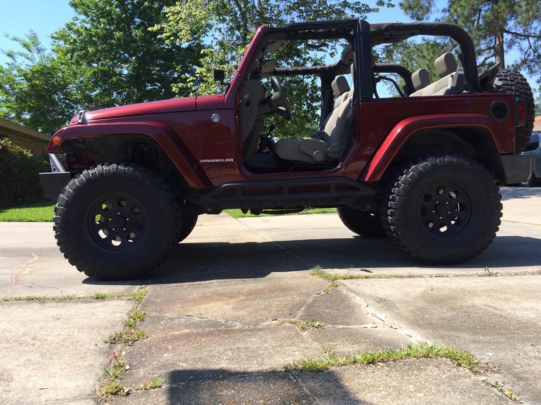

No Adjustable components yet. If the height I gain requires, I will have to change, ie, Drive shaft, control arms, etc
No rake per say. Nothing wrong with the lift. Maybe it is just too much time online looking and thinking of something different to try is all. TF 2.5 lift with daystar .75 spacer is nice but a little bit more is the overall look I like. I know if it aint broke don't fix it. Click image for larger version
No rake per say. Nothing wrong with the lift. Maybe it is just too much time online looking and thinking of something different to try is all. TF 2.5 lift with daystar .75 spacer is nice but a little bit more is the overall look I like. I know if it aint broke don't fix it. Attachment 610351Attachment 610352
So you are sitting at about what our 2.5" coils would set your rig at. So our next step up is the 3.5" kit which you would want to run at least the lower control arms and an adjustable track bar. Our 3.5" flex system is a good one to base your needed components off because that is the minimum that we would advise running a 3.5" lift with.
