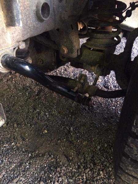

Hello. I have a 2008 jeep unlimited rubicon and recently took my sway bar off, reinstalled and got it working. But now if the jeep is slightly off level. It sounds like metal is rubbing and just isn't good. Does anybody know if the sway bar goes under or over the tie rod?

Sorry to say you got it on wrong, it goes over. Just disconnect the links and reconnect the sway bar above the tie rod.

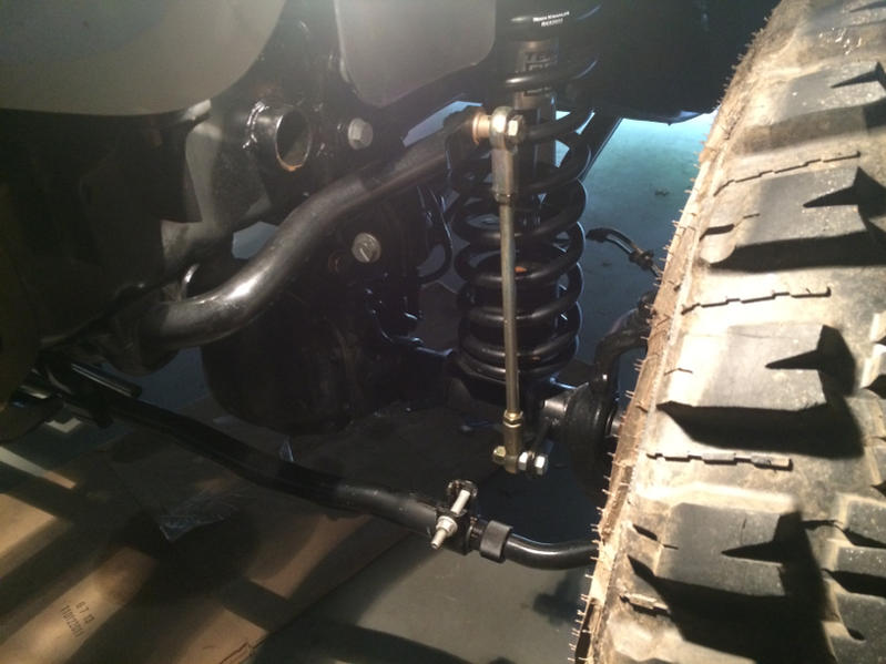

If your being serous here you go... Click image for larger version

ID:	570632 If your joking, it really did make me laugh out loud.... Haha
