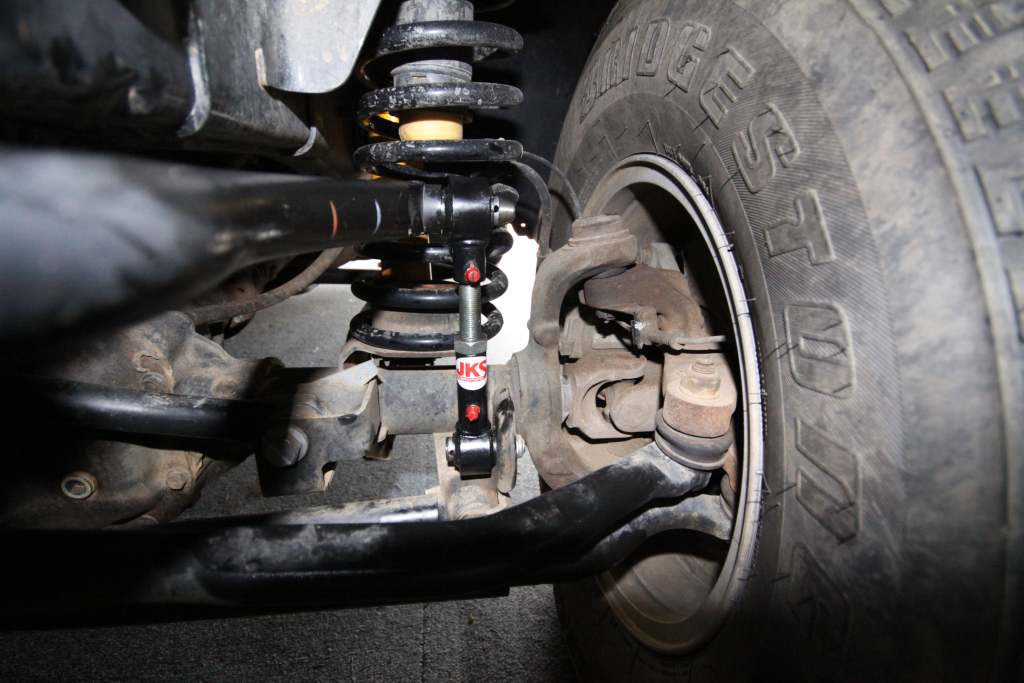

Hi,
For some reason one of my sway bar disconnects are on an angle. Anyone know what would cause this?
See pic.
Thanks

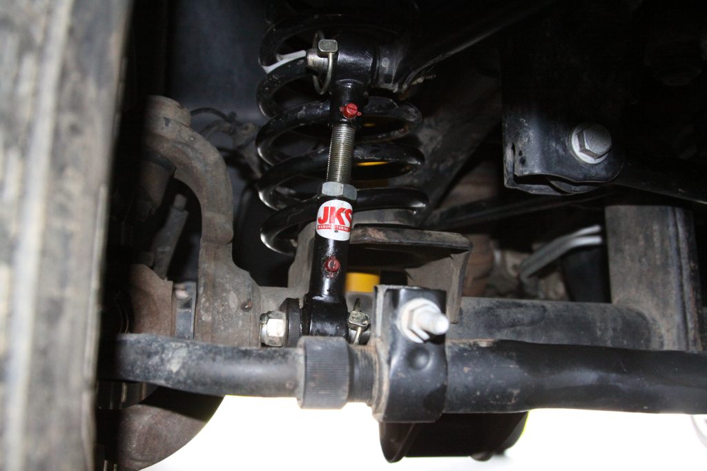

Old Dec 24, 2008 | 03:06 PM
cnewman's Avatar
Joined: Aug 2008
Posts: 26
From: Southend
I Have extended the sway bar disco out a little for the 2" lift.. Here is an updated photo.
The other disco seems to be straight.
Old Dec 24, 2008 | 03:24 PM
greenmachine07's Avatar
Posts: 836
From: Fallston MD
what lift did you go with? the axle may not be centered. if you get and adj. trackbar that would fix it.
Old Dec 24, 2008 | 04:07 PM
cnewman's Avatar
Joined: Aug 2008
Posts: 26
From: Southend
ahh i see. I got the OME2".. got about 2.5" out of it.
Will it cause any wear on the drive line if i leave it like this for a week or so until after xmas?

Old Dec 26, 2008 | 08:56 AM
jonsjeep's Avatar
Posts: 147
From: San Antonio, Texas
i would say the axle is not centered. do you have a pic of the other side
Old Dec 26, 2008 | 11:17 AM
YellowToy's Avatar
Joined: Apr 2008
Posts: 888
From: Mt. Pleasant, SC
My sway bar can also slide side-to-side in its mount. Have you tried sliding the bar over a bit to split the difference?
Old Dec 26, 2008 | 11:58 AM
cnewman's Avatar
Joined: Aug 2008
Posts: 26
From: Southend
Can I still run like this for a few weeks till i can get it looked at?
Other side pic attached
Old Dec 26, 2008 | 12:01 PM
cnewman's Avatar
Joined: Aug 2008
Posts: 26
From: Southend
The other side seems straight.. so if I move it then the other side will be out.
I did try and move it, but the bar was getting close to the chassis, so i moved it back a little.
Old Dec 26, 2008 | 12:57 PM
hig4s's Avatar
Joined: Dec 2007
Posts: 296
From: Jacksonville, FL
May be a silly question, but why is the driver side disconnect adjusted to be as short as it can be and the passenger side adjusted to very long?
