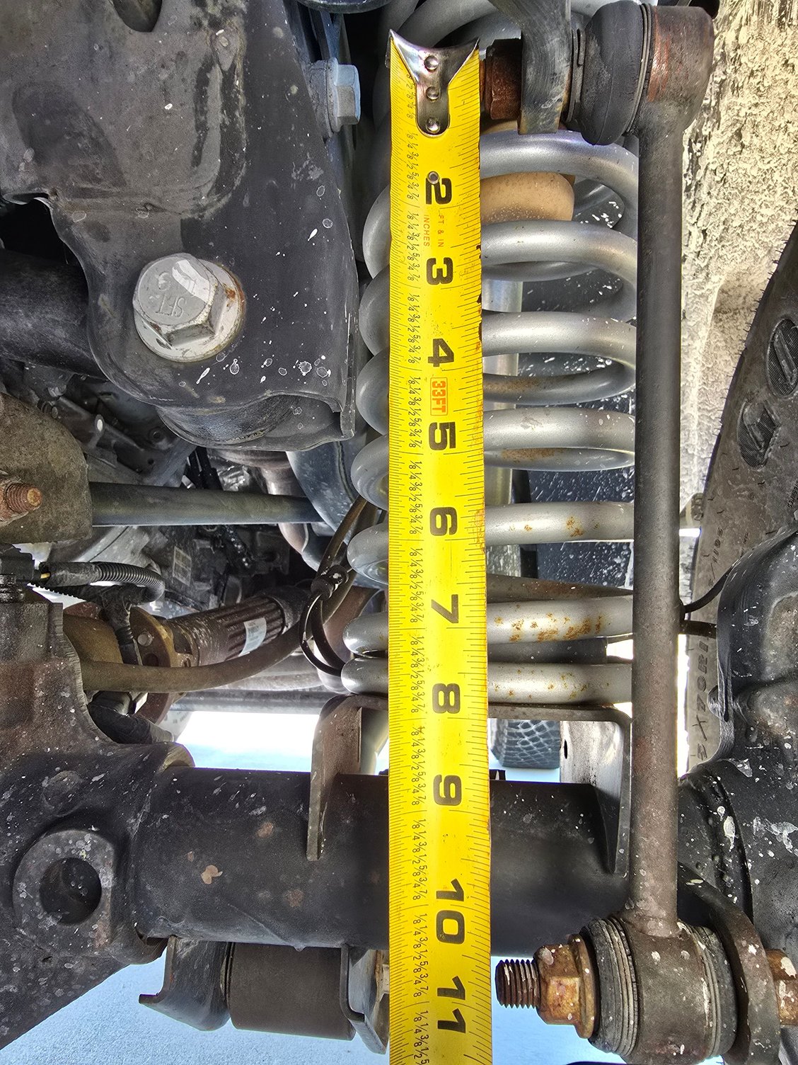

I bought new Synergy adjustable links to replace my factory ones, I believe they are factory? Anyway I think are to short even when fully adjusted out. Is this common and should I just look for longer ones.

A lot of the time people's kits will provide new rears and the old rears move ot the front, so those are not the factory fronts, which are typically very short. Regardless, you want your links to be long enough to have the sway bar angled upwards just a couple degrees. Whatever that distance would mean for your specific jeep......

Thanks Im learning some new stuff here for sure. They look like they are the correct length for the sway bar angle .The new ones are just to short. Any recommendations ?

Looks like these will work.
Teraflex Jeep Wrangler Front Sway Bar Quick Disconnect Link for 3-4 in. Lift 1753005 (07-18 Jeep Wrangler JK)

Jeep builds have a tendency to change over time. I'd suggest getting something that is adjustable so you're only buying one time. I got JKS quicker disconnects back in 2013.....and I still have them. They are so quick to yank off and put back on when on a big wheeling trip.
