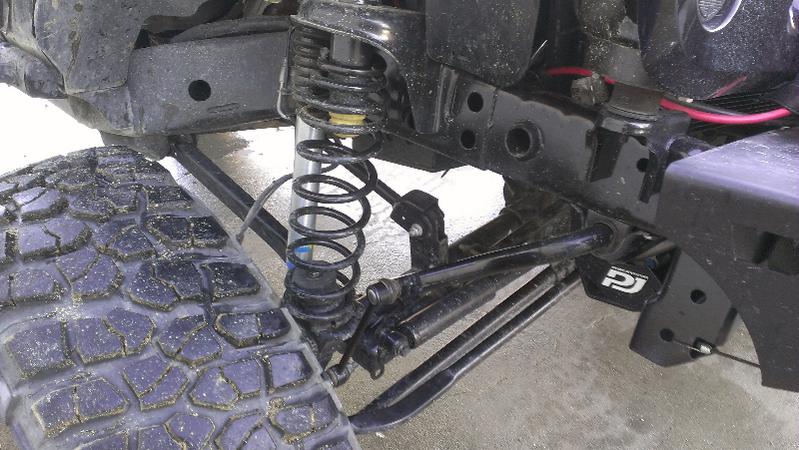

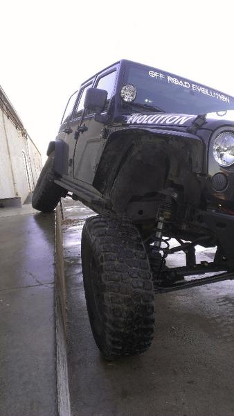

Just put on longer links. I also have the tf 2.5 but I swapped out the front springs for rk springs. The tf kit makes u put the stock rears in the front and they are 9" long, I hade to remove the longer tf rear links (11" long) and put on some stock sway bar links from a ford f350 in the rear which were the same length. Then I put the tf rear links in the front and I haven't had any issues so far with the e-disco flipping the links and bending them. I will post a couple of pics right now
Old Jan 1, 2013 | 06:28 AM
bob-o's Avatar
Posts: 2,215
From: rosamond, ca
Here u go. With the rk front springs, I made some 1" 3/4 bumpstops, and have bilstein shocks for a 4" lift. You can see in the second pic that the sway bar link is not perfectly aligned with the sway itself, there for the chance of the sway bar flipping the wrong way and bending the links is not likely
