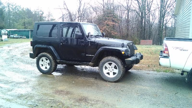

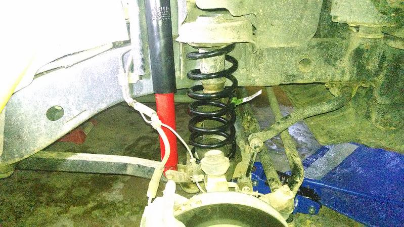

Had 13 front springs and put 18's on and gained about 2 inches and had 3/4 spring spacers so around 2-3/4 lift give or take. Looking at jks links and wanting to know if this will settle any and if I should go with the 0-2 links or 2.5-6 links that jks offers?

I did a 18/59 spring swap on my JK plus I had a Teraflex leveling kit and ran the 0-2" JKS links.
I had an aftermarket winch bumper on the front and an aftermarket bumper and tire carrier on the rear.
The springs will settle a little over time.

Depends... Do you plan on going with a lift kit ie budget boost in the future? If so, why not go with the. 2.5"-... Discos. If you are going to lift, not every kit is going to provide discos, so, save yourself from another future purchase, and get the. 2.5"^ discos..

if in doubt on length, get the longer links.

I have stock bumpers for now and plan on lifting in the future but I'm thinking of putting a winch on stock bumper in the next few months. If the 2.5-6 links would work now then they can be used in the future, I just don't know if it will be to much or will I be safe with them after winch install.
