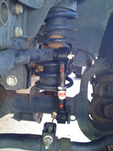

Just installed jks quicker discos. Do I have to do anything with the sway bar after I pull? Sorry for the noob question. Thanks

you should bungie or zip tie them to your frame rails in a horizontal position when wheeling. this will help prevent them from dropping down.
