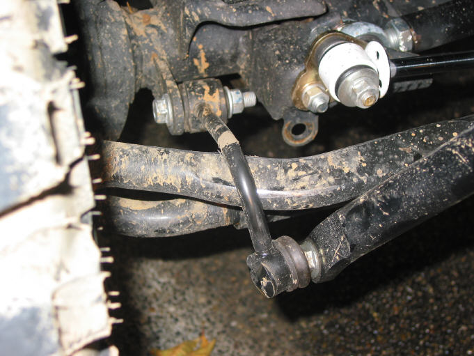

If the lift is too much then you'll bend the links:
That usually happens when your links are too short. It gets stretched out and reverses and gets bent backwards.
Right, so if you lift it and keep the stock links they will be relatively shorter and could bend. Not sure how much of a lift will bend the stock links...
Right, lifted Jeep + stock links = bent links/sway bar. Most kits tell you to relocate your rears to the front and then they give you a longer set for the rears. You want at least a 90 degree bend or close to it where your link and sway bar connect.
