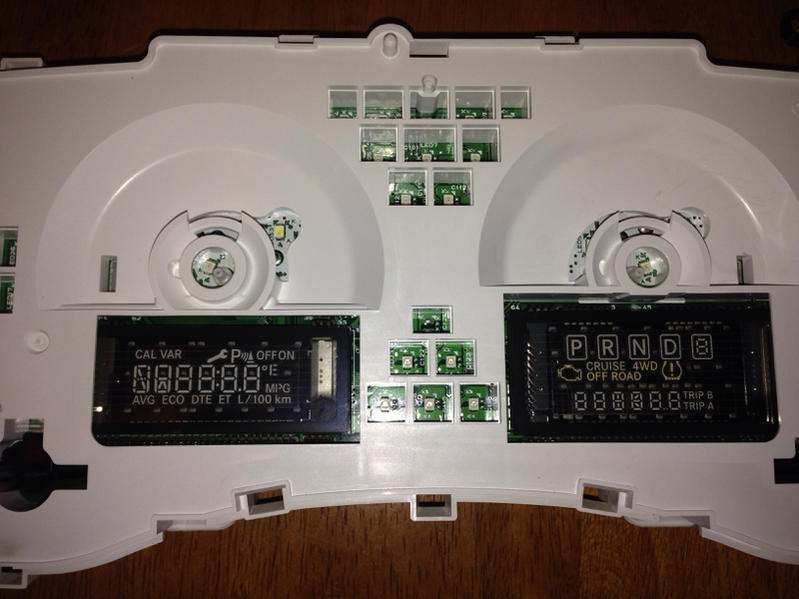

I know many dread this and so did I. But it actually wasn't that bad. I took the gauge out and disabled it and took a knife and took the led out. Then reassembled it wasn't that hard to do and now I don't have the flashing light any more
It's the middle light on bottom row

Originally Posted by Flexer07
I know many dread this and so did I. But it actually wasn't that bad. I took the gauge out and disabled it and took a knife and took the led out. Then reassembled it wasn't that hard to do and now I don't have the flashing light any more <img src="https://www.jk-forum.com/forums/attachment.php?attachmentid=531753"/> It's the middle light on bottom row <img src="https://www.jk-forum.com/forums/attachment.php?attachmentid=531753"/>
This is a really good idea when you pull abs and stuff
