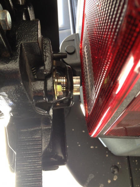

I also just installed the Teraflex carrier. So far, I like it a lot.
