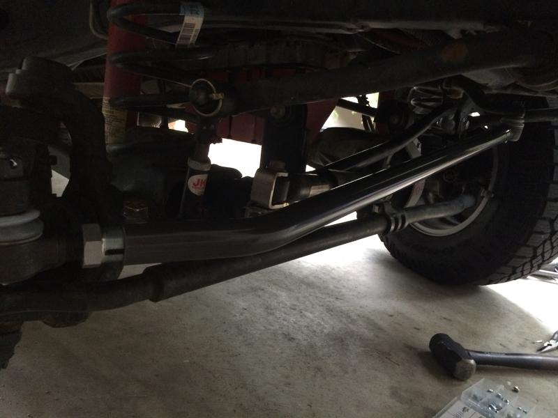

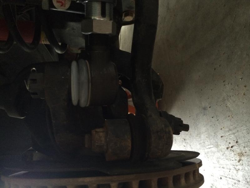

Got this beast installed today. Top grade American made beef Install was pretty painless. I had to loosen the pass side tie rod enough to drop it about an inch to get the synergy piece in. After that centering the steering wheel was a bit of a pain too. After a test drive the wheel was still off a little. Not enough to give me a light but about an inch off center. I think I'm good now, shouldn't have to worry about this monster for a LONG time.
