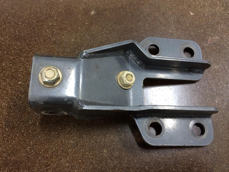

If you are not running 37's or larger you do not need the sector shaft brace. I have an extra Synergy Track Bar Brace for sale if you are interested. It is very beefy and totally reinforces the frame side mount nicely.....Click image for larger version
ID:	541194....$65.00 plus shipping and you can have it.

Originally Posted by jeeperjkjeeper
If you are not running 37's or larger you do not need the sector shaft brace. I have an extra Synergy Track Bar Brace for sale if you are interested. It is very beefy and totally reinforces the frame side mount nicely.....<img src="https://www.jk-forum.com/forums/attachment.php?attachmentid=541194"/>....$65.00 plus shipping and you can have it.
you can destroy your steering on smaller tires than 37's that's like saying you don't need hydro assist until 40's.
most definitely can destroy your steering on any size tire.....but if his Jeep is a daily driver and not a dedicated trail rig then more than likely he will be fine without a sector shaft brace. One you are into 37's and heavy wheeling you will get by with a sector shaft brace but ultimately you will need Hydro Assist anyways which negates the need for a sector shaft brace. All depends where and how he wheels his Jeep is all.
