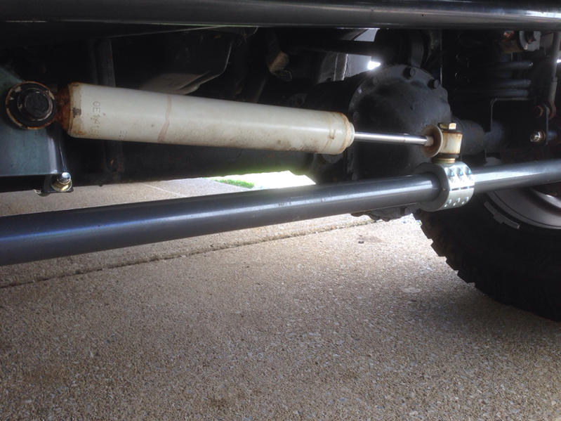

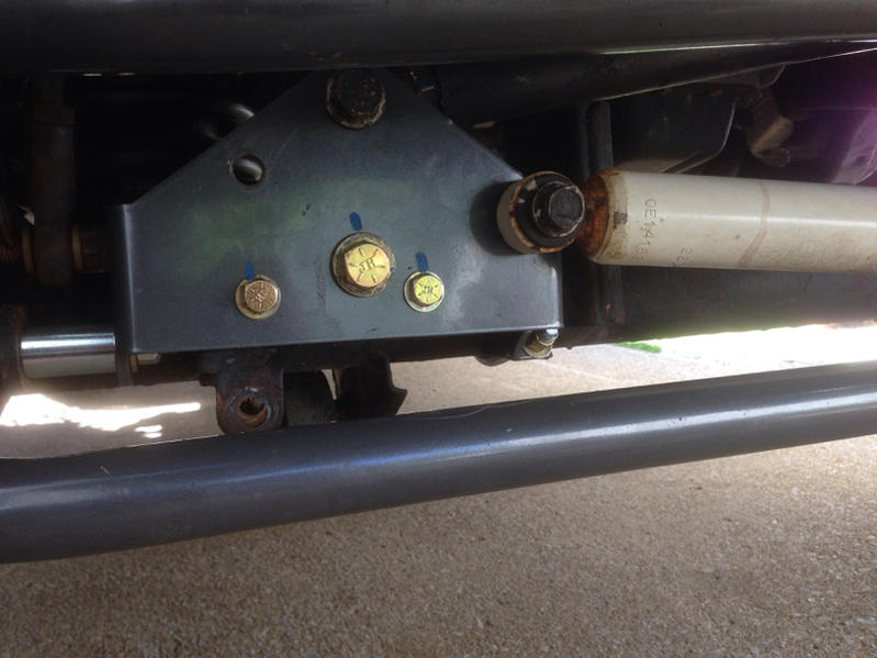

Just installed my new track bar bracket. In the instructions it shows mount the steering stabilizer in the top hole shown in picture. However mounting it here puts a drastic angle on the stabilizer. I opted to use the unused hole to the right which is lower and puts much less angle on the stabilizer. Just wondering if this is acceptable or do I need another type of bracket

It's probably set up for the drag link flip

Or you could loosen the jam but and angle the tie rod upwards which is what I had to do

I did Just have the drag link flipped. It seems
To be working ok this way but the instructions show the stabilizer mounted up in the higher
Hole. Just wondering if there's any consequences by mounting it where I did or if it's all good this way.

When I ran that bracket I used the upper hole. I later got their dedicated stabilizer bracket, which bolts on with the three other bolts & gets the stabilizer parallel with the tie rod.
