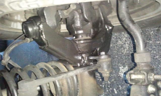

They are great.. Super good quality.. I did them with my friend in his garage not the best welds but they get the job done..

Originally Posted by 305jk
Found this other pic
<img src="https://www.jk-forum.com/forums/attachment.php?attachmentid=430545"/>
Looks pretty good to me. I like the fact that it's both upper and lower C's. They're charging me $600 for the install (gussets and sleeves). I have no experience with welding. Sounds fair and it's a very reputable shop.
