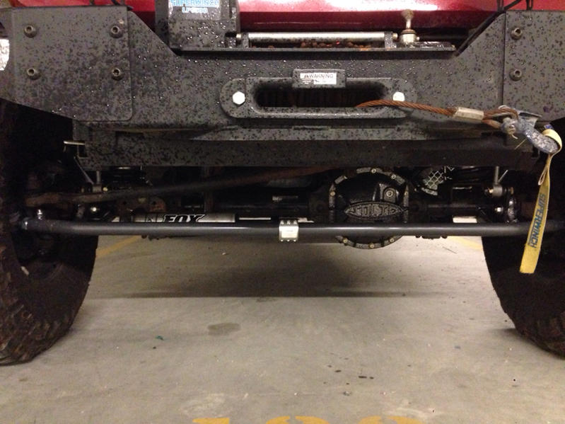

Ya my synergy SS didnt fit either. You're not alone on this one. Mine is mounted oem location until my relocation bracket is installed.

Looks good with that synergy tie rod too, so you just ended up getting a new stabilizer instead of new sleeves in the OEM stabilizer?
My bilstein 5100 ss was bent. When they were replacing my tie rod they discovered the bow in the shaft. Fox ss was all they had. Nice thick shaft and softer charge too. Jeep drives a little better. As for bolting it up, he just used the stock bolt on the axle side and the clamp side came with a bolt from synergy. but the axle side bolt from synergy wouldnt work i guess. Didnt ask why....
