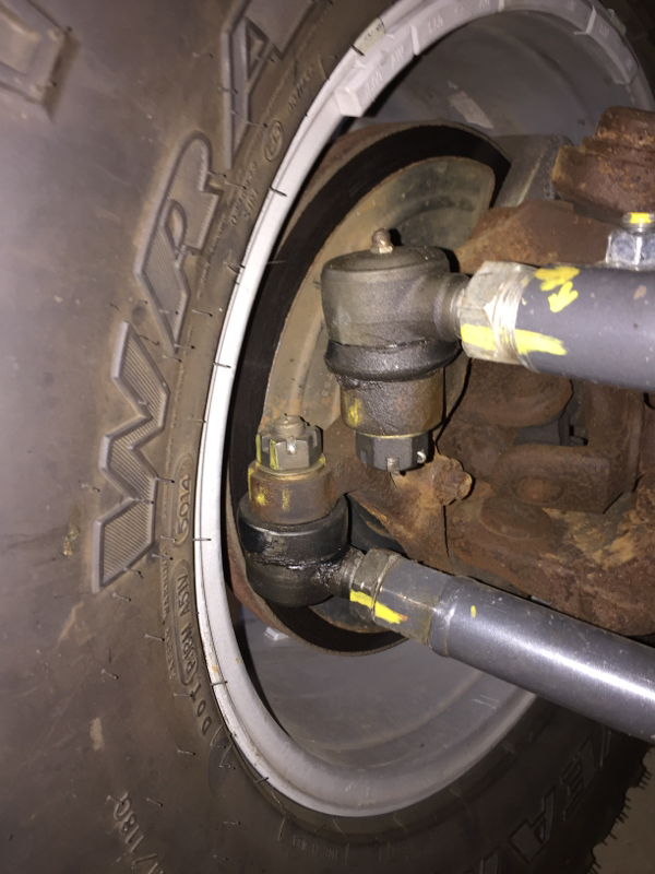

I've had the kit on now for around 9k miles and maybe one off-road trip. Seems the spring slipped off the boot. Got it back on no problem but not sure how long it was like that allowing debris in there. Anyone else with the Synergy kit have to fix this regularly? Hoping it was a one time thing but now I guess I'll have to inspect it much more regularly.

My boots are all torn. I grease them every oil change ensuring they're getting fresh grease. Jeep gets abused and I haven't had an issue in 2 years.
The boots hide the mess of having grease everywhere. Don't worry

I have the same setup and similar problem. Found a couple rubber boots from synergy's older style tre's, they worked better. (Call Synergy/Poly Performance) I also have a psc ram so I went with synergy's thicker boots to keep the tie rod from rocking up/down. So essentially i went away from the spring held boots, they never stayed on when they were on the setup to start... Like the links, have a couple other synergy products, well made.

My boots on my synergy tie rod do that, not so much the drag link. I think every time I've gone to grease them (every 5-6k miles) I've needed to put a spring back in place on one of them. As long as you are greasing them regularly I don't think it's a big deal just fix the springs back in place when you notice it.

I have found that if there is less grease in the boot it stays on better. The grease in the boot is really wasted anyway. They don't need to be bulging with grease.

Personal preference on how much lube is needed... There is not much space to fill in any TRE, BJ or UJ, so either listen or look to see when the Lube emerges from the joint. Keep in mind there is already lube in the joint, unless its new. Too much added then you'll have a mess 50miles down the road, especially from a UJ.

Happened all the time with mine. Keep fresh grease in the joint and it will be fine or get a new boot .. They are cheap.

Before posting here to learn about others experiences I had sent an email direct to Synergy support. They responded promptly and offered to send me their newer boot design. I accepted and within a few days I had them in the mail. That there is an example of excellent customer service and why Synergy will continue to get my money.
