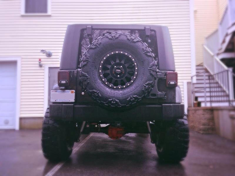

TF Hinge on my Jeep...
I love my Teraflex carrier and hinge. Solid built and quiet. Just ordered the accessory mount and a 48" hi lift x-treme jack.
