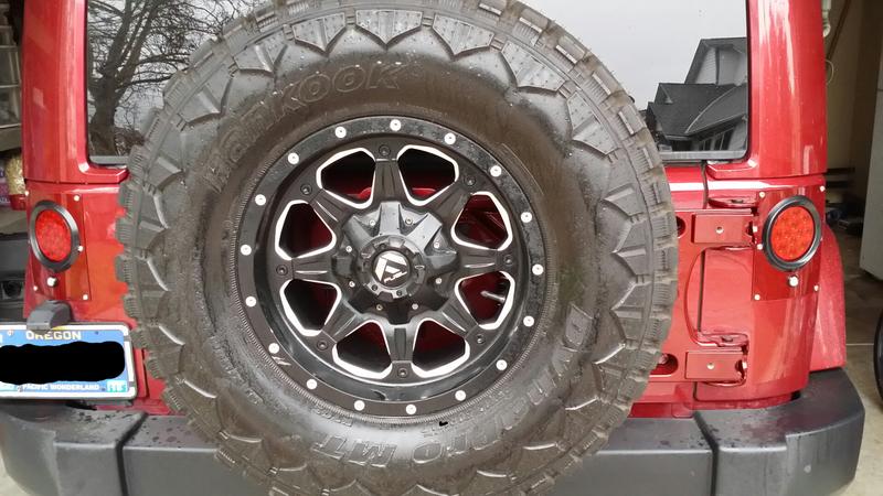

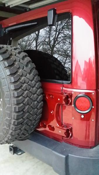

I just finished installing a TF carrier. It was super simple. Hardest thing to do was swing it open a little after taking out of box to start the installation. I put it on first then my Flush mount LED tail lights. I powder coated the carrier the body color and the plates on the taillights. Turned out great. The two jobs together took me about 5 hours with some interruptions and dinner break.Tire sits higher, feels stiff at first to open close just cause teflon hinges are new. I did the adjustable tire mount too along with the hi lift accessory. The TF carrier took about 45 minutes with air tools. Use the styrofoam in the box for your spacers during install. I learned that from u tube video of a guy who video he install. There is other little tricks I learned from u tube videos and researching on here and other sites. Like painting behind the stock hinge bracket before putting in the new one. Can you believe JEEP installed a hinge covers on the line then painted over so there is no,ZERO, PROTECTION. U can buy the matching paint by mopar for your year and color.

Default Just finished my Teraflex and Taillights
ID:	534086Click image for larger version
Just finished installing mine after getting it powder coated.

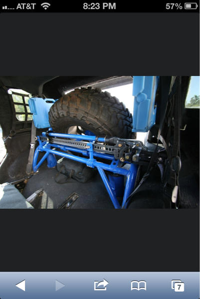

I was going to do the teraflex hinge, but then I found a better alternative.
