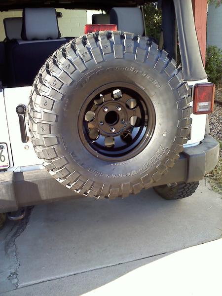

35" KM2s on pro comp 8069's. 4 LBs over my stock spare. WIN!

it's not just the weight. You also have to consider leverage
Im looking into having a shop shortening my tire mount to pull the tire as close to the tub as possible
