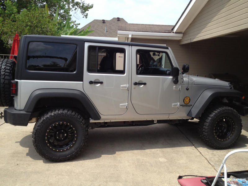

Well I did it. It took me 6 hrs but seemed to go fairly well. I installed the RC 3.25 lift today and was kinda fun. Had experienced some problems but nothing to brag about. Front shocks went in well with a little bit of prying with a crowbar. The rears went in with a charm. I have only installed a RC2.5 before in a TJ with a little help. Today I was flying solo for most part with a little help from roommate that never did this before, and a girlfriend that was nice enough to text me the whole damn time. It's in and I feel pretty proud of myself that I can label myself as a part changer now( that's basically what it is). Thanks for the advise from y'all that took the time to lend a little advice.
