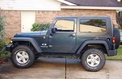

I will throw some photos up shortly.

First try at photo attachments...
Before
After
LnuFnu
2.5 Tera bb
285/75 16 BFG a/t's
ID:	601   Click image for larger version

wow ..that looks awesome....i knew about the sway bar and the washer issues though..that was documented before

looks good, but I would swap those washers around when you have time, b/c it seems to fit in better and be less stress on the adapter with the bigger hole on the bottom, so it makes the adapter slide up a little more. but probably not gonna hurt anything to leave it for a little while, but I would swap as soon as you have time. Good job getting it done!
